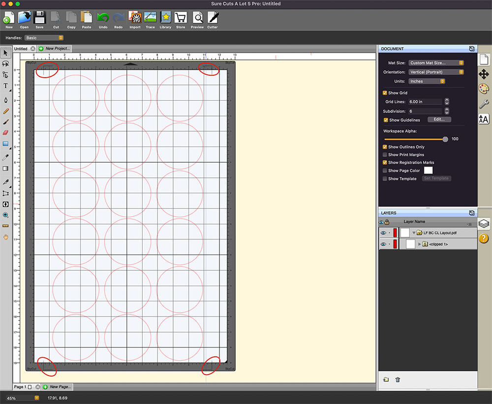

The registration marks in SCAL show up way outside the cut area (about a 1/4") example below,

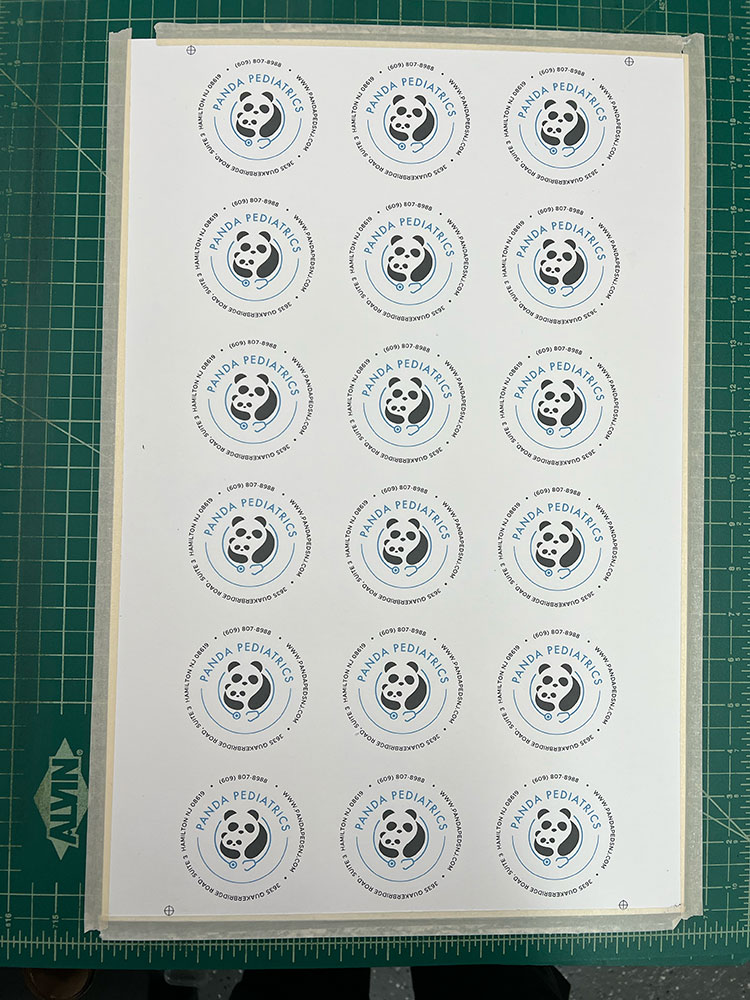

Here is a image of what I'm cutting and the reg marks already printed. This was printed the way I set them up for MTC.

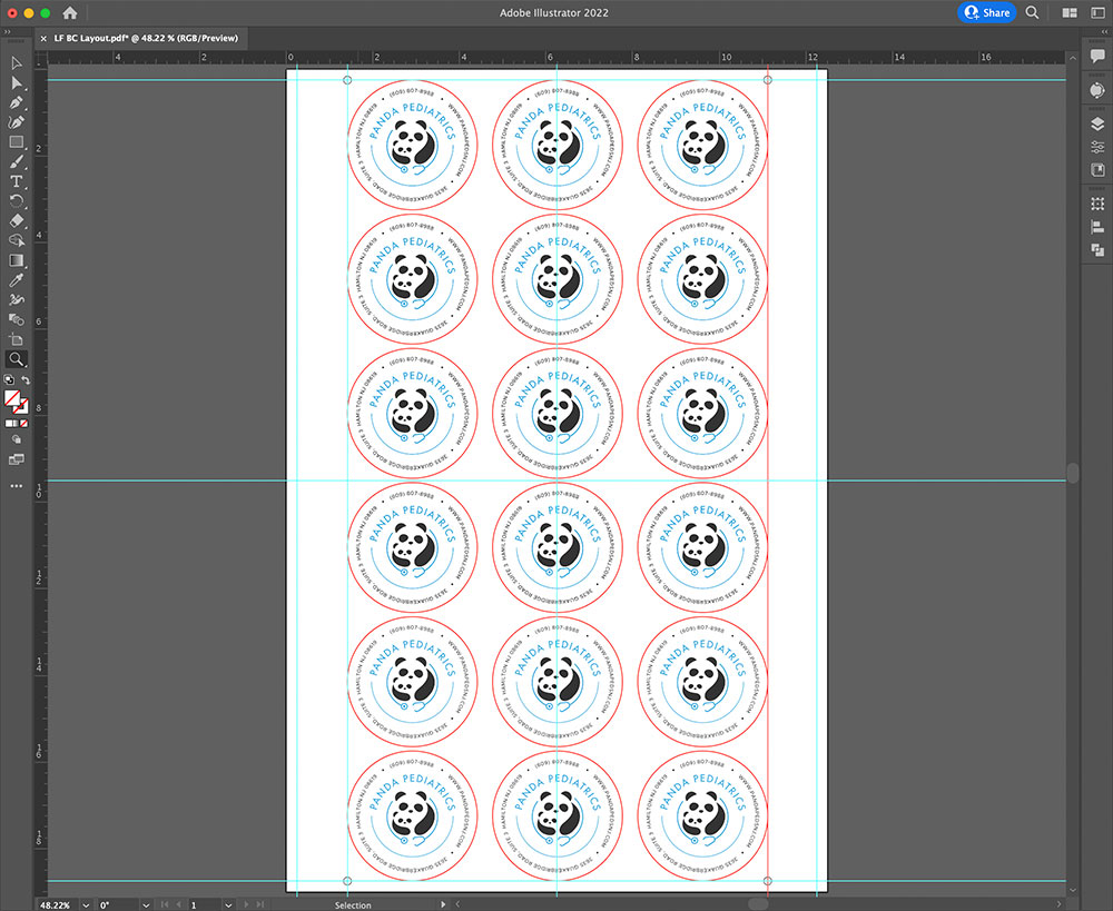

The registration marks I have printed on the sheet are set right where the cut lines are and it's always how I set it up with MTC. Make a pdf of the paths being cut and make sure the reg marks meet. Example of it in Adobe Illustrator set with the marks and guides showing how the marks meet with the cut lines (red circles).
The other issue and how SCAL handles the reg marks. MTC always started the first reg mark at the 1,top right, 2,bottom right, and 3 bottom left and would go back to origin point which is the bottom right corner of the sheet.
The sheet sizes I usually print on are 11" x 17", 12" x 18" and 12.5" x 19". The one in the pictures is 12.5" x 19". I made our art board 12.5" x 19" in the SCAL Matte size and it's set a vertical. I adhere them to a 18" x 24" self cutting mat.

Look under Cutter>Cutter Settings and change from "Mark Offset Around Design" to "Mark Inset from Print Bounds". Then the setting below will position the reg marks based on your printout dimensions + required margins by your printer settings. Note: be careful about enabling Borderless printing without minimizing the Extension/Expansion setting (which can also be called something else).
