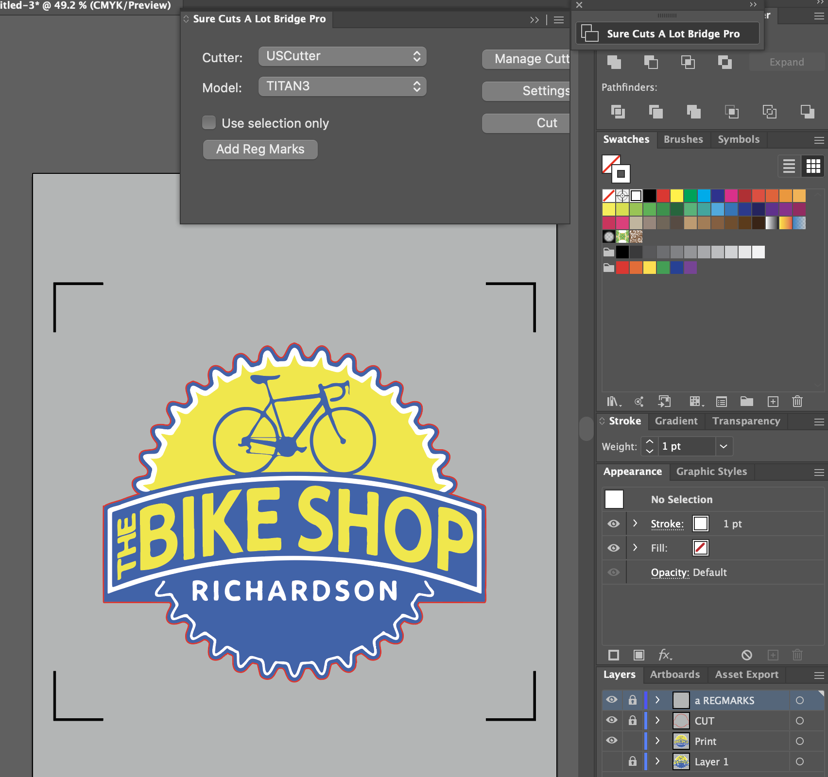

Okay... see if this works. In AI, rename the layer name so that it ends in .REGMARKS
Re: SCAL Bridge Pro : How to cut from illustrator
The plugin for AI, uses SCAL.REGMARKS for the layer name when you click add registration marks, although they don't transfer to the cut settings dialog that opens up (shown in my original post). ROFL
I renamed that layer to a.REGMARKS and the registration marks come across, partially.
Illustrator: Sure Cuts A Lot Bridge Pro

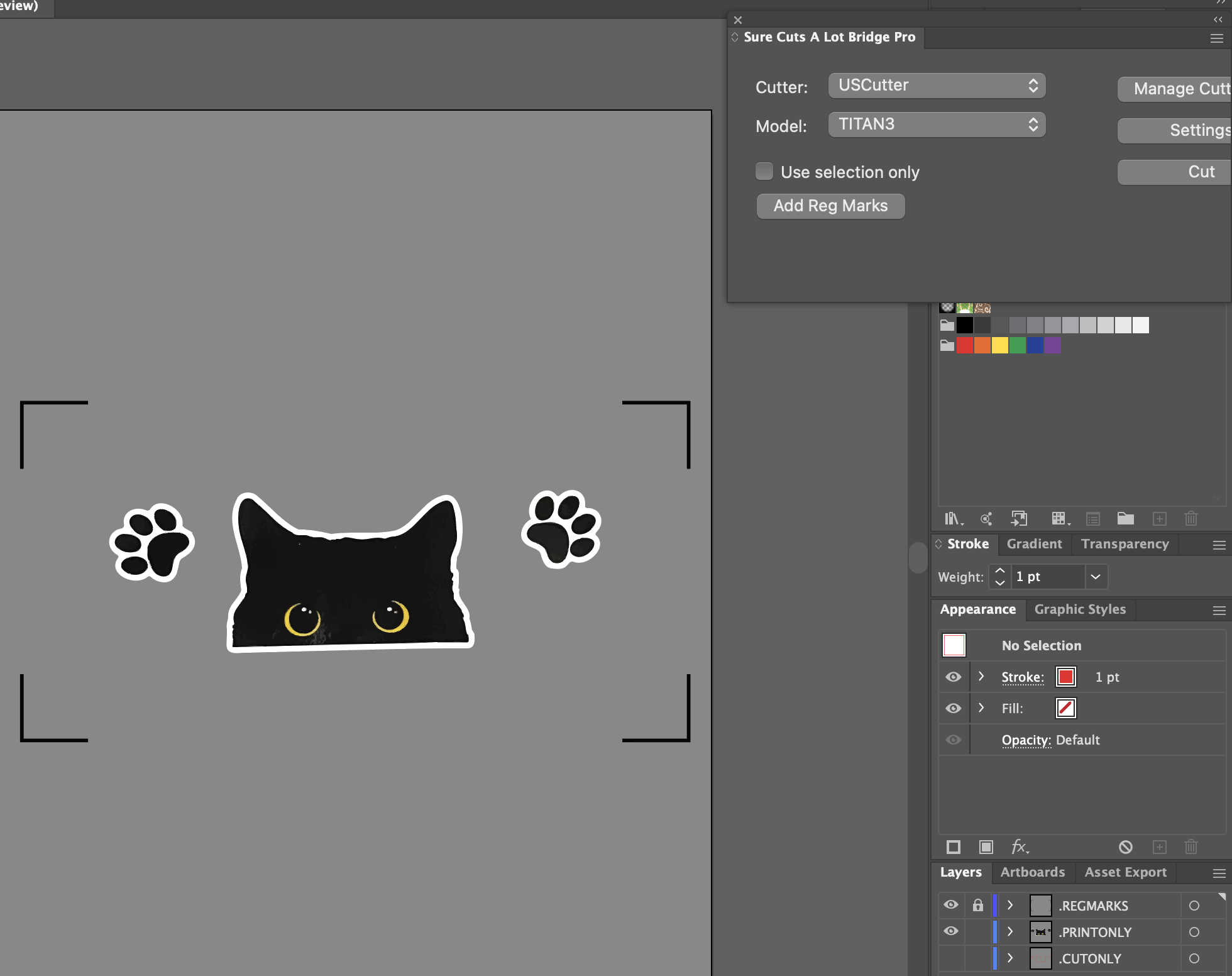

I still don't have the Bridge working from Corel Draw, but I did find some additional naming formats for you:
SCAL.DRAW – This layer will be set to draw with a pen instead of cut with a blade
SCAL.CUTONLY- For Print+Cut purposes, this layer will be set to cut only and not be sent to a printer
SCAL.PRINTONLY – For Print+Cut purposes, this layer will be set to print only and will not be sent to the cutter
SCAL.COLORLAYERKEY – When using Cut by Color, the layer will be cut with all of the other colors cut (PRO version only)
It still doesn't make sense why your project is appearing in the SCAL window with the reg marks "off the page." If you create something much smaller, does it do the same thing? Paul, my friend in Australia, is working on getting the bridge to work from AI and will let me know what he finds. Unfortunately, neither of us own a Titan but hopefully, if we can get it working with our Skycuts, the same discoveries will work for you.

I tried a smaller image and the registration marks come across correctly, if I name my layer .REGMARKS (SCAL.REGMARKS does not work)
I still can't get the print-n-cut print layer to populate in SCAL Bridge.
