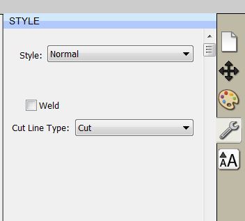

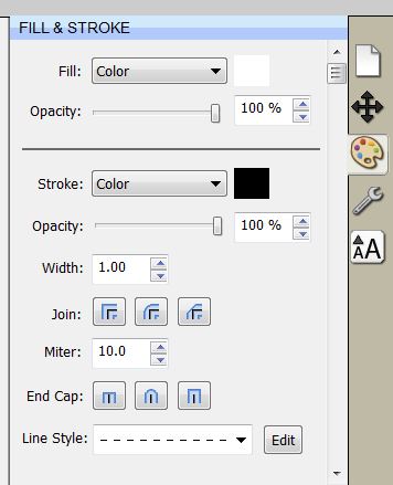

Can you post some screenshots? Specifically, have the dashed line selected and then show both the Style Panel settings and the Fill & Stroke Panel settings.

Post by Betty Boop »
Thank you Miss Sandy! See the attachments you requested. Please do let me know how else I may provide information to help solve this mystery.
061720 Stitched Rectangle Dashed line Style.JPG (19.09 KiB) Viewed 9893 times
061720 Stitched Rectangle Dashed line Fill and Stroke.JPG (31.2 KiB) Viewed 9893 times

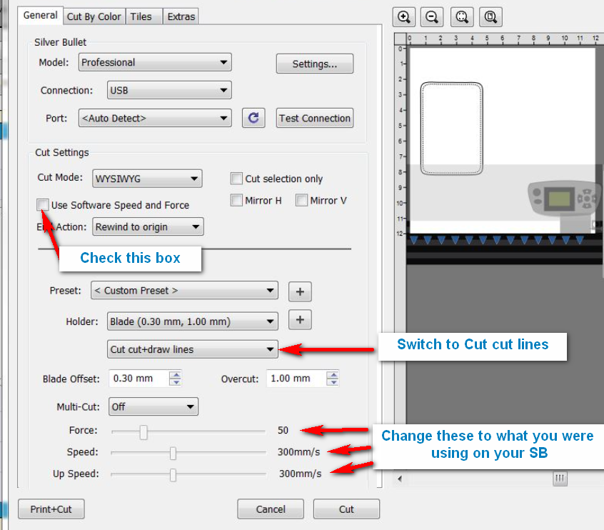

Re: Cutting "Stitched" objects
Well, it worked fine for me, but then I don't have a Silver Bullet to test. One thing I want you to try... these changes:

Thank you for the idea. unfortunately, the results were the same - only the solid line was cut.
