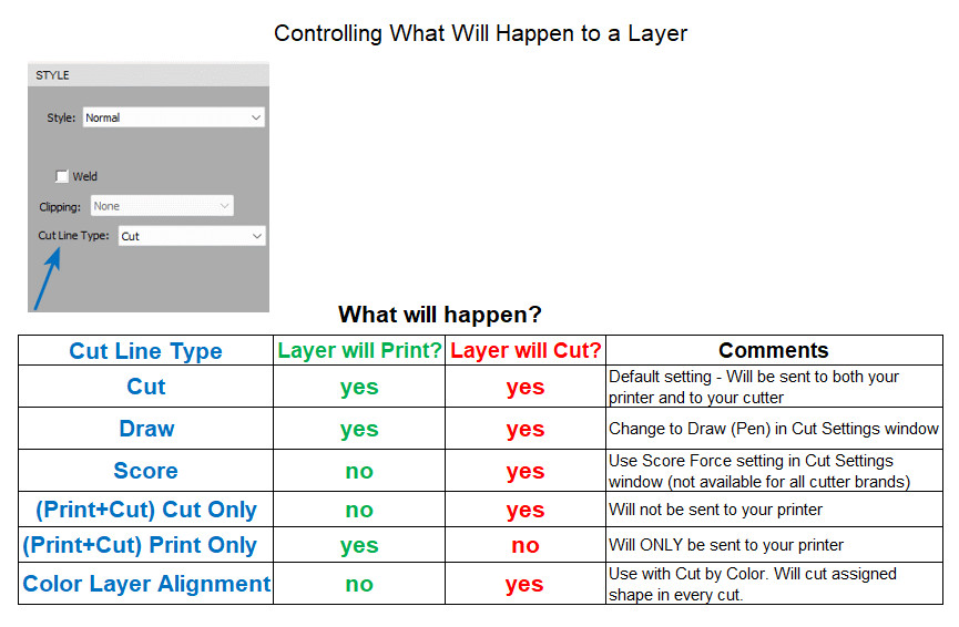

Please note again, what I wrote in my response. If you leave a layer set to "Cut", then it will BOTH print AND cut. Here's a look-up table for you to use:
Cut Line Type.jpg (128.43 KiB) Viewed 19626 times

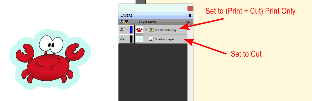

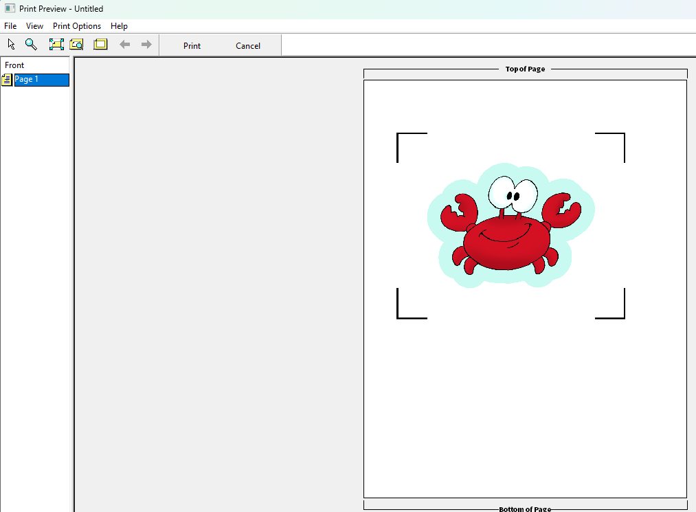

In case you didn't realize it, you do NOT have to choose one of the (Print + Cut) options when doing a Print+Cut project. The layer should be set according to what you want to happen to it. I do a LOT of print+cut projects with layers set to Cut so that they will both print AND cut.
For example, I want to have a colored contour shadow around my imported image. Here's how I would assign the layers:
And when I check my printer's own Print Preview, this is what will actually print:

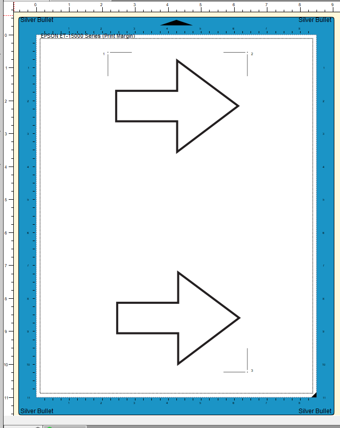

To calibrate the Calibration numbers for your SB, you need to be using a shape that has both horizontal AND vertical cut lines. I've always taught my customers to use arrows. Ignore the diagonal cuts and focus ONLY on the horizontal and vertical lines so that you more accurately determine which (X or Y or both) need adjustment. Also, have two arrows so that you can verify they cut with exactly the same error. If they differ, then look at what's causing THAT to happen - Speed is too high? Blade is cutting into the mat? Pinch wheels are sticky? Etc. Also, keep both facing to the right so that you don't inadvertently put the printout onto the mat upside down. Of course, with the SB that's less likely to happen since there ARE only 3 marks and they're numbered. Also, use copy paper only... you want something that's easy to cut and you won't cry if you have to use 8 sheets of it before your calibration is perfect. :)
