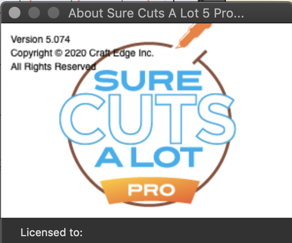

Okay good. So, what is the exact version of SCAL you're running based on the flash screen you see when opening SCAL?

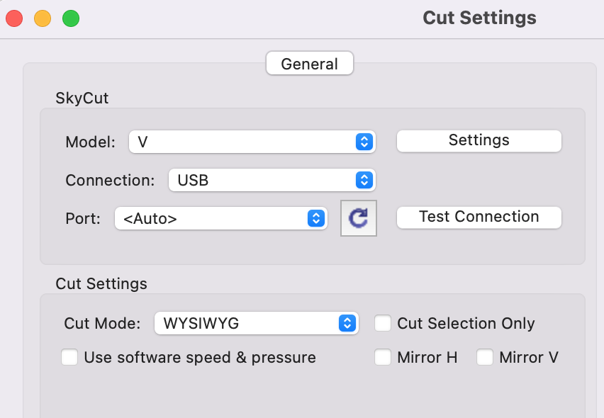

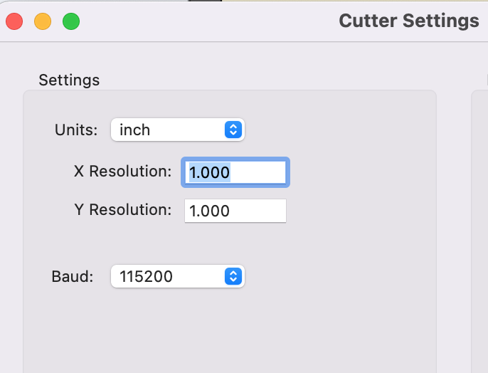

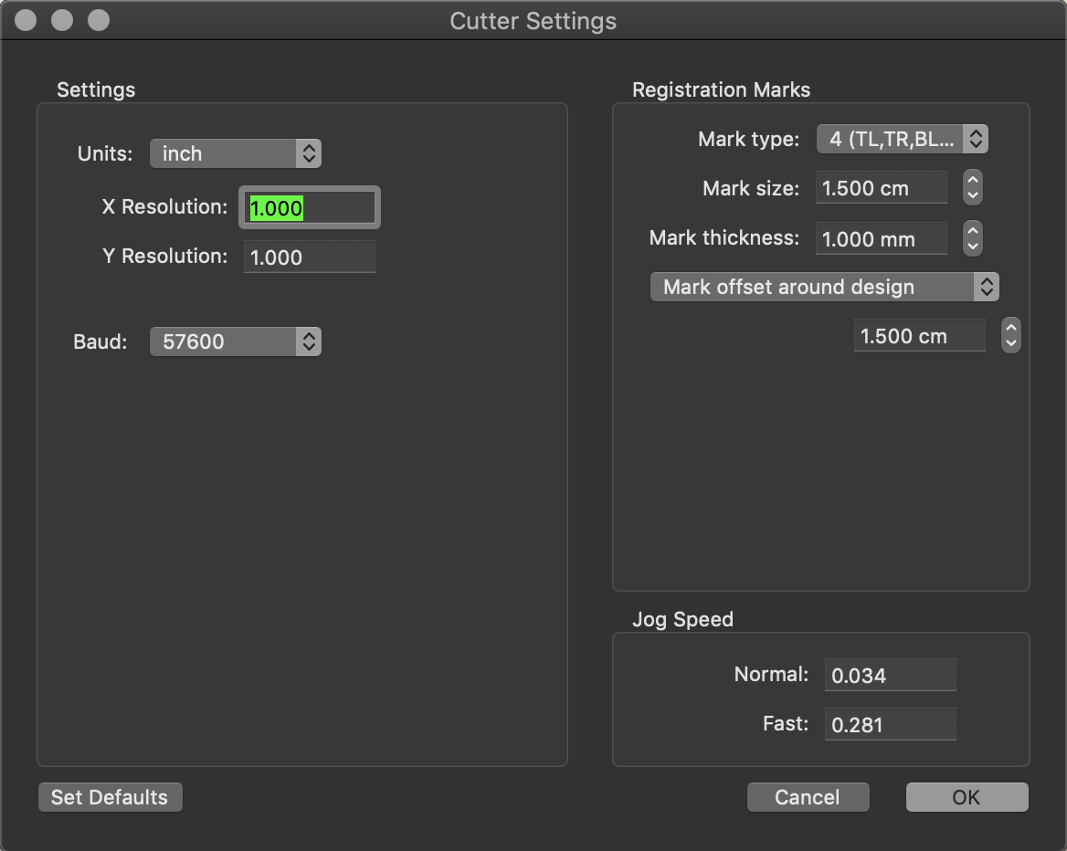

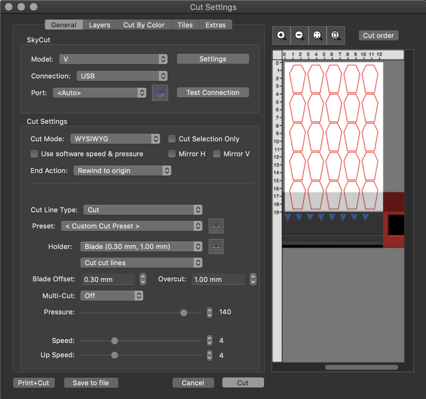

Also, please compare the following two screens with mine. The second one is opened by clicking on Settings in the first one:

This is everything I have going right now.
I've been talking to the company that sold me this machine currently and awaiting his response.
I was able to get it connected through wireless connection. But USB is a no go. Nothing has worked at this point. I even bought a new USB A to B cable just to rule out a faulty USB's cables I used if they were and they're not. At this point I'm leaning towards a faulty port on the machine for the USB.

Also, the Baud rate is set for what the Baud rate is on the machine 57600. I can't change it on the machine when I go to Sys Information it reads "57600-L"
