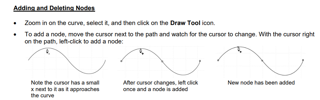

To add a node you need to use the Draw Tool function (5th icon down on the Tools Panel). Below shows a screenshot from my SCAL5 User Manual:
Here's a link to the UM: I cover this add node part in Section 5.04. The rest of node editing is covered in Section 6.10

I would select my shape. Then try to use that tool. I was not getting that + sign ON an existing drawing. It kept placing a new node on a new line so when I moved my cursor it was trying to have me draw a new line/shape.
I finally have the knack of getting it ON the existing shape.
