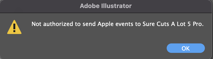

I am trying to use the `Send to SCAL5Pro` script for illustrator on MacOS Monterey and getting what looks like an automation permission error.
SCAL launches and then a dialog saying 'Not Authorized to send Apple events to Sure Cuts A Lot 5 Pro' displays.
Same thing happens if SCAL running or not.
I have gone into Security And Preferences to see if I can allow the permission with no luck, I ran the script from a terminal and a system dialog opened up telling me to grant permissions and those permissions fixed it from terminal but not from illustrator. There is no permission listed for Illustrator under Security & Privacy -> Automation
I found this in the logs:
2021-11-14 08:12:32.153408-0600 0x84a621 Debug 0x0 24179 0 Sure Cuts A Lot 5 Pro: (AE) [com.apple.appleevents:main] ASKING TCC FOR PERMISSION TO PROCESS EVENT ears/ffdr from <private> timeout=120 seconds

Unfortunately, I cannot help you with this one at all, as I don't have Illustrator. Paul does, but he doesn't own a Mac.
