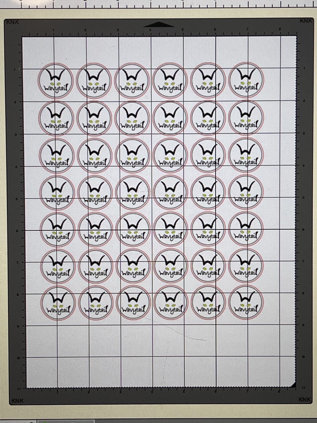

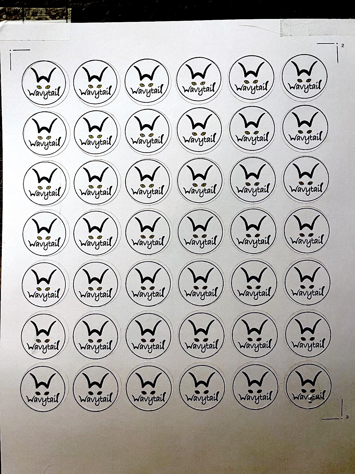

I'm trying to use Print and Cut. I'm printing the file from SCAL first. It was created in Affinity Designer if that makes any difference. Then I come back to cut it, and go through all the lining up on the registration marks. I did the 'calibrate laser' thing. I'm using a KNK Zing Air.
However it seems like the circles that it cuts are sized smaller on the page than the print. So the only ones that are even slightly centered are those in the middle, whereas the corner circles are pulled towards the center and not lined up on their printed equivalents.
Can anyone advise if I'm doing something wrong? Thank you.

AND THEN THE PENNY DROPPED.... I have been getting success when I print only the cut circles. Failures when I print the logos. Which are smaller than the cut circles! So the registration marks move closer in, which offsets the cut circles....
Fast forward an hour or so and I have finally figured out that SCAL has an assignment capacity to tell the different layers whether to print or to cut. This didn't exist in my previous software, which is why I was treating them separately. Printed the logos, cut the circles on some plain paper (from the rear tray) and it behaved perfectly.
Did the same with the heavyweight sticker paper and the circles are a little offset again, but uniformly so this time. Not sure why they are still offset; could this be the difference between heavyweight paper and printer paper? I did the alignment carefully. It's way better than how it was before though.
