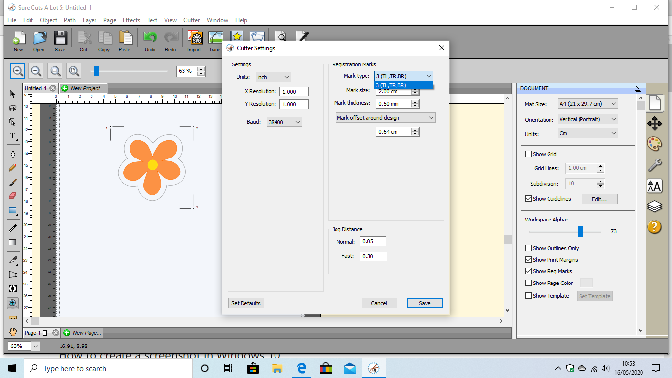

hi please help I can only get 3 registration marks tl,tr,br.and my cutter will not recognise them,ive watched videos etc everyone has 4 registration marks what am I doing wrong,thanks in advance

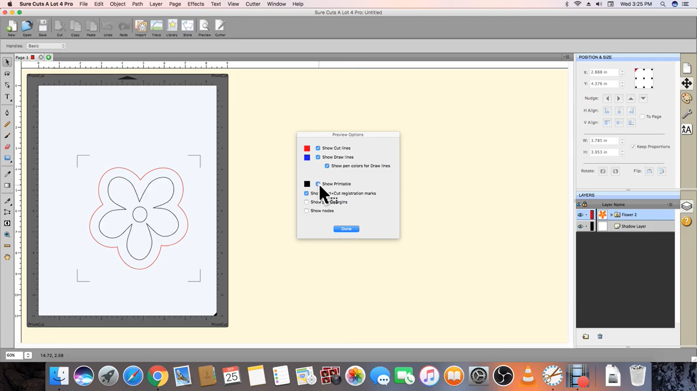

hi sandy here is a couple of screen shots first of video scal 5 contour cut
2nd screen shot of me trying to follow the video hopefully something will be obvious to yourself

Okay, thanks for the screenshot! VERY helpful because the video indicates it's SCAL4 pro, which I also own. I opened it and UK Cutter is not a listed cutter but that could mean that a different cutter's plugin also works. Either post the video here or if the video shows the Cut Settings window, take note of what cutter model is displayed there.
